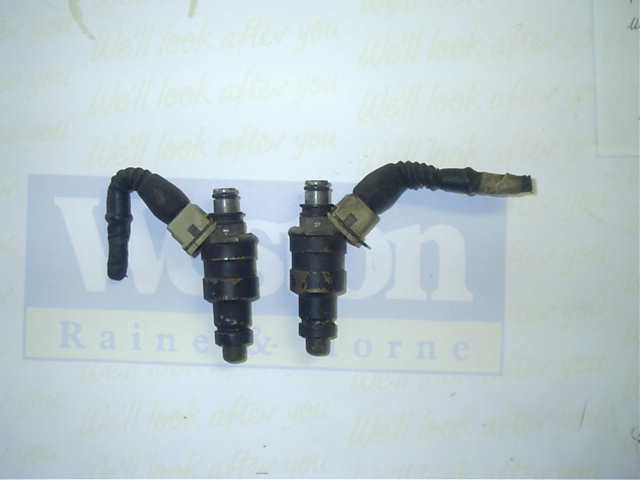

Posted:Mar 11 2003, 11:37 PM |
also here is a pic of the 460cc 13b non turbo injectors
