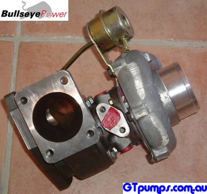

Do you have any pics of the flange for the turbo to exhaust manifold(standard) or do you know what they look like, are they similar to the mitsubishi VR4 4G63 there is a pic added to this?
