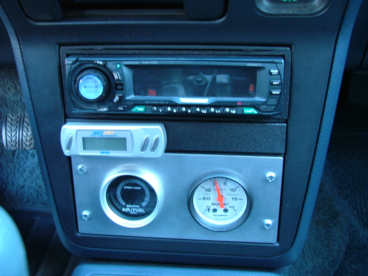

how about this? its the crutchfield install kit for the cd player with the Blitz DTT and air/fuel guage and boost guage from a mustang saleen.

| Posted:Mar 27 2004, 03:41 PM |
machine, just curious how you had that metal backing plate made. I would like to do something like that only black in color.
-------------------- 1992 MX-6 GT turbo |
| Posted:Mar 27 2004, 11:44 PM |
| I made that cover out of the original cup that was there(sun glasses holder) and a sheet of aluminum. First i cut a hole in the plastic cup for the wires to run out the back, then cut 2 holes in the uluminum for the guages and 4 screw holes. I lined the aluminum up with the cup to get the correct placement and then drilled 4 pilot holes for the screws. The screws are from what you would see in a bathroom in say a retail store(very cheap but look great) After that i brushed the aluminum and clipped it in. thats all |
