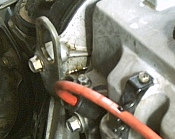

well after degreasing again this morning, i took the thing out for another quick lap and when i popped the bonnet i was amazed at the amount of oil that came out within the short period of driving. You cant really see much oil in the pic's (not the best digital camera) but at this rate im sure i will be going thru quite a bit of oil in just a week...

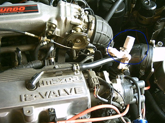

The most alarming thing happened when i revved the car just after returning from the quick lap and heaps of white smoke was coming out of the cam cover oil to intake pipe (3rd pic) upon deceleration. I then removed the oil cap can heaps of white smoke was also coming out from there, after a few revs tho it all returned to normal, whats the story? is my engine screwed?
After further inspection it looks like there are spots around the cam cover where oil is leaking, no where near as bad as the one indicated below but still worth noting. Hopefully after i change the gasket everything will be ok, that white smoke tho is really alarming me.. Also will i need some sort of sealant when i replace the cover, maybe place the stuff on both the top and bottom of the gasket?
here are some pics
You can see a little oil in this pic, basically thats where the oil is coming from

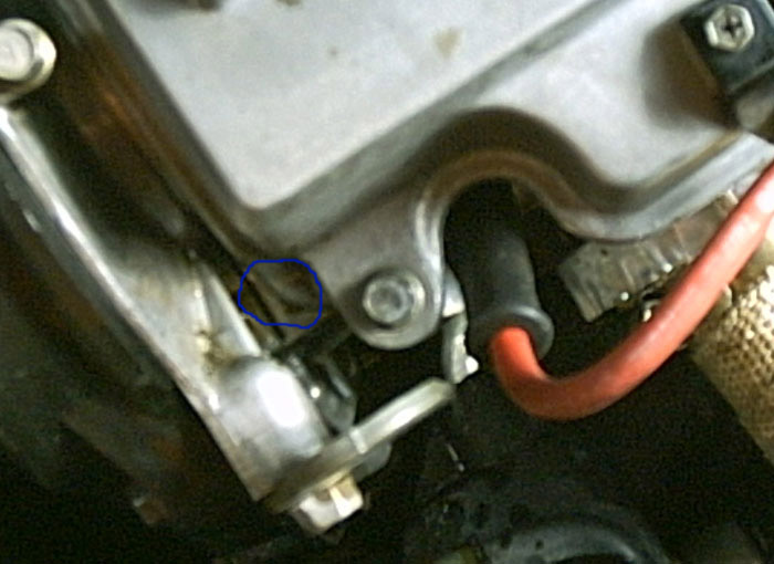

| Posted:May 24 2003, 12:26 PM |
top view, i know its hard to see but the leak is coming from where the cam cover rests on the head within the blue circle.
| Posted:May 24 2003, 12:27 PM |
crack case air pressure pipe disconnected from intake
