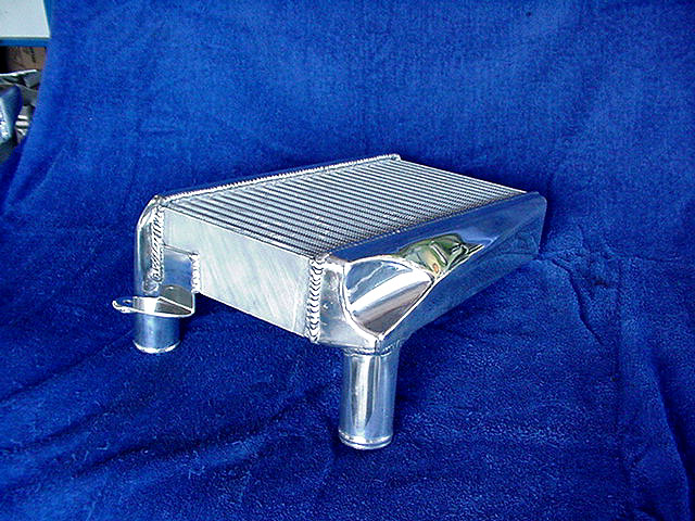

heres someone you can talk too in qld..
http://www.are.com.au/
the manufactures of this ic which went for $1000 - $1200, same setup as the original just a little bigger in every dimension.... you can actually get something a little bigger if you want but you will need to mod the bonnet latch and perhaps get a smaller fan off a newer car... new stock ic's are $1200 from japan so it should be an option, goodluck!
This post has been edited by mx68u on Mar 11 2003, 12:30 AM

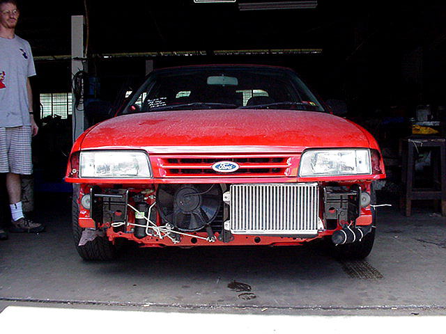

| Posted:Mar 11 2003, 12:27 AM |
on a tx5

| Posted:Mar 12 2003, 06:55 PM |
yeah if you can get the piping done in the same format as the longer and widther the pipe's the more lag you will experience, true the top/bottom endtank design isnt the most efficient but it is a good compromise to keep the turbo boosting early
Certain truck cores can be good but not all of them, some of the internals are just too big with fins that are really small reducing the effectiveness on air cooling so beware. Also since no truck cores are efficient as aftermarket performance cores you will be required to use a larger core to do the same job, if you dont want to cut up your bar than maybe something like the one i posted will be the better option as it will enable you to fit the biggest and more efficient core |
